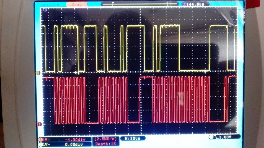

I tried to connect the HTS221 to the ATtiny816 via the I2C bus. The data availability survey was conducted 2 times per second:
if ((HTS221_GetCTRL_REG2() == 0) && ((HTS221_GetStatus() & 0x03) == 0x03)) {
         HTS221_GetData(&HTS221_Rx_buf);
Oscillograms of STL and SDA lines were correct, regardless of the amount of received data (1..4 bytes).
Converting the resulting data resulted in correct humidity and temperature results.
However, with constant interrogation of the sensor, SDA line was blocked in the lower state in a random time. And further work was resumed only with the re-power on the Vdd.
This lock occurred both in case of auto-increment reading of results registers, and one at a time. This block occurred both during the automatic start of the conversion (tried 1 and 7 Hz) and “one-shot�?.
The blocking of SDA lines was resolved only in the case of reading only one register, for example HUMIDITY_OUT_H. This allows to obtain humidity with an accuracy of 1%.

Hi Lehman, could you share the oscilloscope pattern?

Lehman
Hi, Eleon.
Ok. Easy!
For example - reading CTRL_REG2 (SubAddress = 0x21) - image 1.

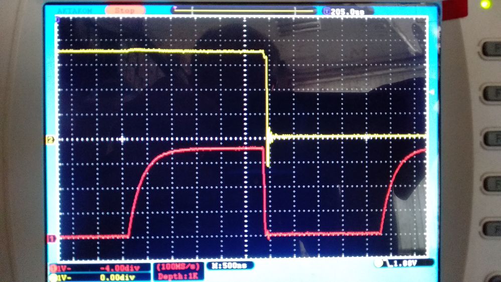

Image 2 - 500nS/dev expansion of point near +60uS on image 1.
Driver i2c - handmade. I have not found for ATTiny.
However, the ATH10 (China) sensor is located on the same i2c bus - it does not hang.
Pull-up resistors (SDA, SCL) - 5k6.

Eleon BORLINI

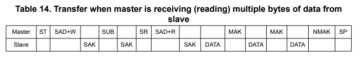

Hi Lehman, so you are building your I2C pattern in bit-banging, right? I'm checking your I2C patter for the multi-byte read case
First data byte is correctly read, while the second one is't. Are you correctly managing the MAK?
