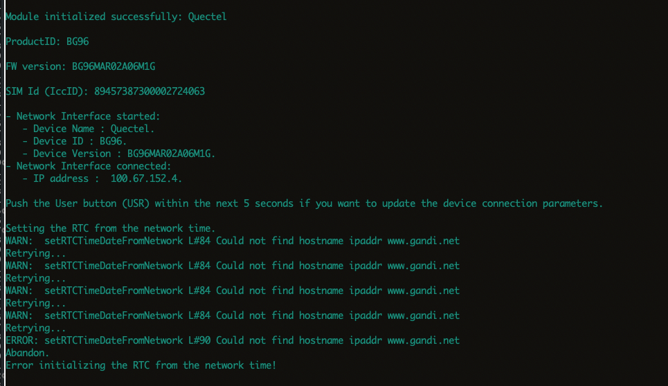

I am using STSW-STWINCELL demo application on STEVAL-STWINKT1B with STEVAL-STMODLTE, most of the time I keep getting this error but once in a while it works fine, it connects and sends the topics to AWS.
Can you please help me fix this issue?
SIM which I am using work perfectly fine on my phone, so there is no connection issue.
0693W000008xuVjQAI.pngKind Regards
Chandrashekar C
 Hi @Chandrashekar C​ ,
I checked with our experts and they say that it is unfortunately an issue related to the server chosen for the synchronization with the TLS protocol.
In fact the cellular module is perfectly connected to the net as shown in your picture, with his own IP address.
They suggest the following procedure:
  1. Open the file “main.h�?
  2. Remove the comment at line 90 (#define USE_CLEAR_TIMEDATE             // see 'timedate.c')
  3. Compile again
  4. Download the new firmware.
Please let me know if you can fix the issue in this way.

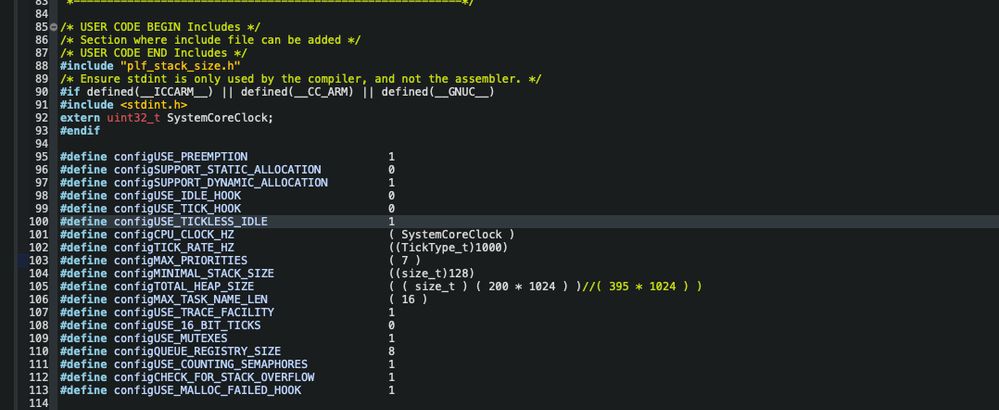

Do you think it's anything do with setting Tickless to 1 to achieve Low power mode?
#define configUSE_TICKLESS_IDLE                  1
0693W000008y3bHQAQ.pngPlease let me know if I can tweak in anything else.

Hi @Eleon BORLINI​
I also notice that the binary provided in STSW-STWINCELL [STSW-STWINCELL_BG96_V1.0.0.bin] also behaves same [ RTC failure ]
Is there any other working binary which I can use?
I am using SIM card from onomondo
Any suggestion is much appreciated.
Kind Regards
Chandrashekar C
Our experts performed some tests (described here below) without encountering issues. The outcome is that your issue could be related to supply problems.
Test configuration:
HW
  • STWIN
  • STMOD+ expansion board with Quectel BG96 Cellular module
  • M2M SIM provided by TIM to use NB-IoT infrastructure
  • Power supply able to provide 5V@1A
FW
  • STSW-STWINCELL
    • original binary firmware as in the provided package (RTC synchronization with TLS protocol using www.gandi.net)
    • modified binary firmware as previously described (RTC synchronization with TCP protocol using www.st.com)
Please find attached the log files.
The modem obtains the IP address and can configure RTC from both www.gandi.net and www.st.com.
Their suggestion is:
  • supply with at least 5V@1A the STWIN that is connected with the STMOD+ cellular board. A lower current capability could be the cause of the issue;
  • connect the STWIN directly with the power supply without any USB hub.
-Eleon
Hi @Eleon BORLINI​
Thank you so much for your detailed response and patience.
Looks like there is an issue with network provider, Onomondo SIM on specific network fails to connect to www.gandi.net or www.st.com.
Currently, we are whitelisting selected network and it seems to be working :)
