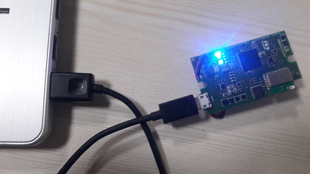

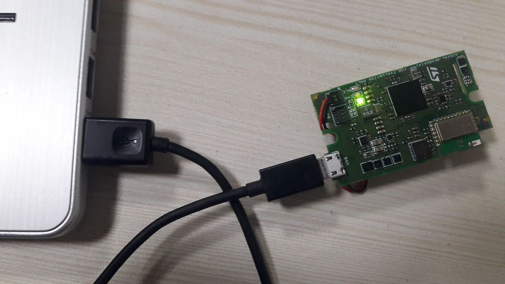

I flashed E:\SENSORTILE\STM32CubeFunctionPack_SENSING1_V4.0.1\Projects\STM32L4R9ZI-SensorTile.box\Applications\SENSING1\Binary\SENSING1.bin in st.box by "st ble sensor app using smartphone", and the firmware flashed successfully, i was doing that because i was trying to obtain the dataset(sd card log) for different activities by adding a label as shown in the documentation UM2524 (page number 31 to 35).
but after doing that
  1. i am unable in getting the log file(datset) on the SD Card inserted into st.box
  2. also now GREEN LIGHT freezed and
  3. the box is not also charging and
  4. sd card is not getting detected as the usb drive in "my computer/this pc(where the harddrives are shown)"
  5. sometimes it is not getting showed in the devices list (connect the device)
and i have tried by disconnecting the battery and pressing the power button on the board it some times help in displaying the device in device list but all the points above (1-4) are not getting fixed.
what should i do??
i am attaching the photos so that it can be more clearer and also the video of application
