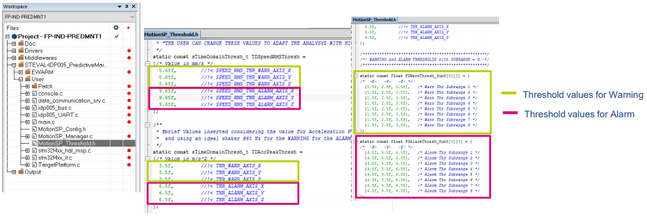

  • PredMaint_SVR project from \Projects\STEVAL-IDP005V1\Demonstrations\Predictive_Maintenance_SRV folder (here below a description of the modification of the alarm and warning thresholds for Speed RMS, Acc peak and spectral band. It is done in precompiling phase on MotionSP_Threshold.h file)
