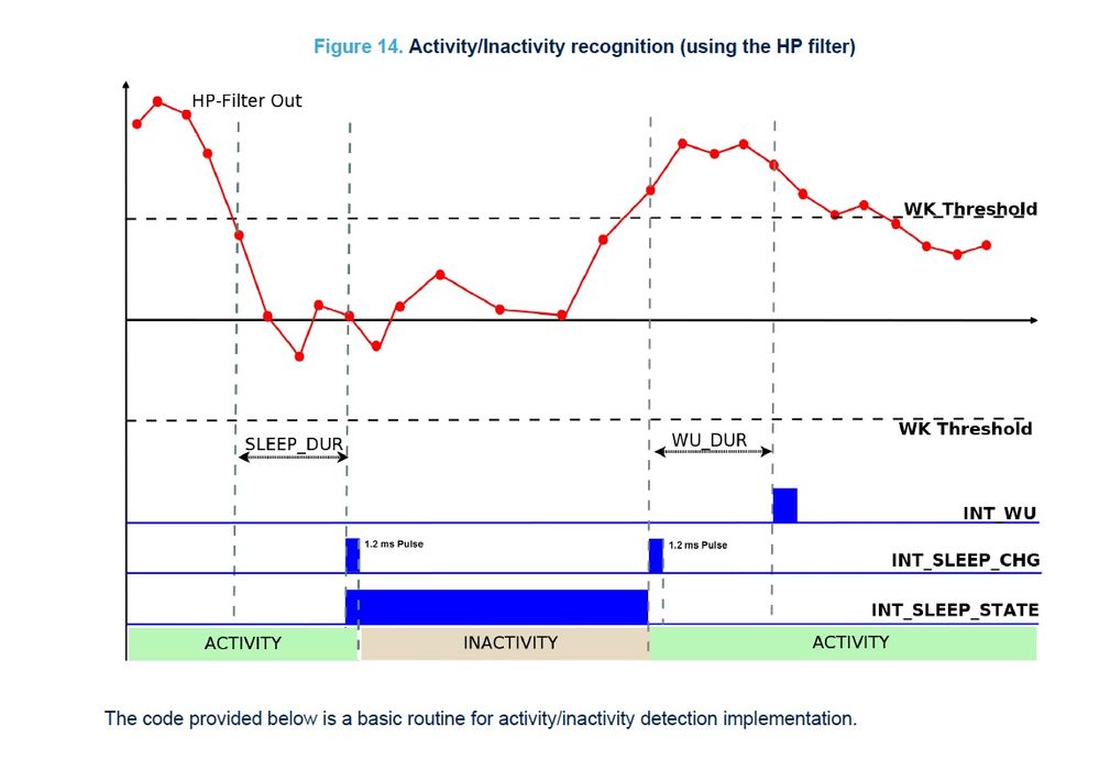

Can you please little explain how it works stationary/motion detection works.
Similar graph like it is for activity/inactivity and is it enough to put the STATIONARY bit to "1" + settings for activitiy/inactivity to put sensor in stationary/motion detection mode?0693W00000FAMdjQAH.jpg
KWine
Senior
If you use LPower1 mode at 1.6 Hz and stationary bit set to 1 you can get wake-on-motion and sleep-on-no-motion behavior at about 0.55 uA as I measure it. So it works the same as activity/inactivity just when there is no activity the sensor does not default to 12.5 Hz as when stationary bit is left at 0. rather, the sensor stays at 1.6 Hz LPowerMode1, which is the lowest power state, whether awake or asleep. Pretty cool!
