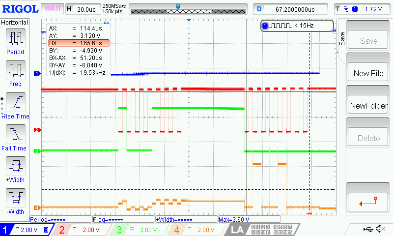

asm330lhhxg1 "who_am_i" register is reading back 0x48. Should be 0x6.
arifkhan
Connected STEVAL_$MKI243AA board to a nucleo-g491re board using 4 wire spi interface. The spi bus is setup to run @ 146 Kbits/sec. Reading back bad data.
WHO_AM_I is 0x48
PIN_CTRL is 0x3E
Not sure but seem like the device is power

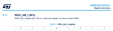

Why should it be 0x6?

Hi @arifkhan ,
The correct whoami, as reported also by @TDK , is 6Bh.

hello Federica,
Yes, i have the scope connected to the 4 spi signals, I see 0x8F go out on the MOSI and I see 0x48 on the MISO wire every time.  I put a 10k pullup on the CS wire and also a 10K pulldown on the INT1 signal.

Please show your scope trace.
Use the scope's screen capture if possible - it will give much better results than trying to photograph the screen!

ch1- csn,
ch2 = spi clk,
ch3 = mosi,
ch4 = miso.
SPI cycle read of WHOAMI register spiAddr = 0x8F, spiData = 0x48 (should be 0x6B).
spi mode 3 i.e. clk polarity high, clock 2nd edge.

I connect the STEVAL_$MKI243AA module into the steval-mki109D board and i can read the whoami register as 0x6B (i see it on the scope also). But if i connect the same  STEVAL_$MKI243AA to my nucleo-g491 eval board with jumpers (4 wire spi), the board is giving 0x48 for the WHOAMI register.
what is the steval-mki109D board doing special to make it work?

Something is clearly very wrong with your MISO:
@arifkhan wrote:
Do you have a good ground connection?
