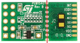

Hi, I got the VL53L1X Satel board but I am not able to link the exact pin names to the pin numbers of the breakout board. Can anyone please assist me? Thanks in advance
MBabu.2
reference : https://www.st.com/resource/en/data_brief/vl53l1x-satel.pdf
0693W000008xdNJQAY.png0693W000008xdNEQAY.png0693W000008xdN9QAI.pngAs you can see, I have the names of the pins from the data sheet but I don't know which is pin 1 or pin 2 and so on

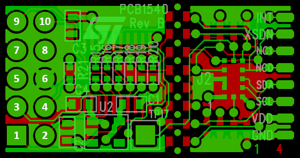

Peter BENSCH
We are very sorry that this cannot be seen from the circuit. Pin 1 is the square pad of J1, pin 2 is the first pin of the second row next to it (see picture below):
0693W000008xeNPQAY.pngWhen your question is answered, please close this topic by choosing Select as Best. This will help other users find that answer faster.

Thank you so much
