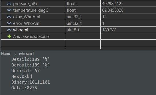

When I start to debug the code I have this situation:
0693W00000Dm7jGQAR.jpgI'm runing my code using FreeRTOS (CMSIS_V2), in the task of barometer readings I'm checking all the time WhoAmI register and puting in two variable counters, one for erros and the other for correct readings. I realize that one time a wrong reading happen and after this only correct readings happen (10111101 value or 189 in decimal as explained in datasheet). The pressure readed in hPa was 402982.125 hPa the expected values for my city is something around 1000 - 1020 hPa and the temperature in celsius degrees the expected was 22 - 26 celsius degrees and not 62.84ºC.

More info:
I taken this SPI configs from datasheet informations.
What I have tried (without success):
  • Changing the baud rate prescaler.
  • changing CPOL to "Low" (when I make this change I notice that I have rigth values from WhoAmI register but whong and nonsense values from sensor )
  • changing CPHA to "1 Edges"
  • set a delay after setting CS line to high/low
  • set a delay before/after reading with SPI_Transmit / SPI_Recieve
I'm without ideas about how to fix this, can anyone give some options?
