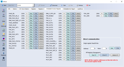

I am suspecting that the ODR setting in my application is not correct. I want to be using 25Hz so according to the datasheet I would set register address 39h to 48h. 25Hz equals 001 which would give 01001000 = 48h.
But all examples and also the Unico tool outputs 4Bh instead of 48h. Am I missing something or should the last two LSB bits always be 1 instead of 0?

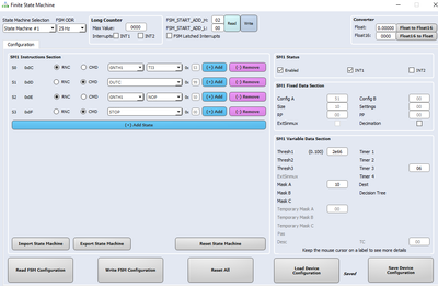

Thank you for the answer. I don't have access to the evaluation kit so I can not read out the values like that. However, I tried the below configuration from the Unico-Gui (using the LIS2DUXS12) and the resulting code when saving the Device Configuration results in 4Bh stored in position 39h.

Federica Bossi
Ciao @BD651 ,
I didn't realize you were using the FSM tool, we checked and you are right: this is a bug. I have already warned to fix it in the next version. In the meantime you can manually change the value of register 39h from 4B to 48.
Sorry for that.
