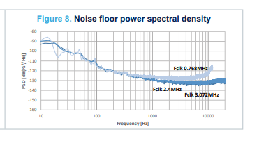

I'm using an MP23DB02MM digital mic on the CCA02M2 eval board and using the PDM2PCM library. When I have no sound into the microphone the noise floor I see in the data from the PDM2PCM output is around 1,000 counts peak to peak noise. I'm struggling to understand how to use the datasheet SNR and Sensitivity figures to get a noise floor figure. My calcs make the noise I'm getting look really high, even considering there might be a little tiny bit of acoustic noise getting in. What should I expect roughly as a peak to peak noise from this setup? I'm running at 48KHz output PCM rate with decimation of 64.

You find the noise floor at page 6 of the datasheet:

Yes I have seen that, I've spent some time looking at the datasheet, but my problem is I don't understand how to relate those figures to actual measurable noise in the PCM data as digital peak to peak values.
For example, if I have the microphone isolated from any sound, capture the PCM data as 16 bit signed values and analyse it in a spreadsheet I can get peak to peak and RMS noise figures, but I don't know how to relate this to the specification for the microphone so that I know my system is performing roughly OK.
My figures just seemed quite large, so I'm wondering if I have some problem.

What integral noise value do you get (with a 20Hz-20kHz bandpass) and applying the A-weighting filter? For MP23DB02MM you should obtain noise = sensitivity - SNR = -26dBFS -65dB(A) = -91dBFS(A)

Around -90dBFS(A) was the calculation I made from the data sheet, but I thought it seemed like a very low level of noise, but you have confirmed that this is the correct figure - thank you.
