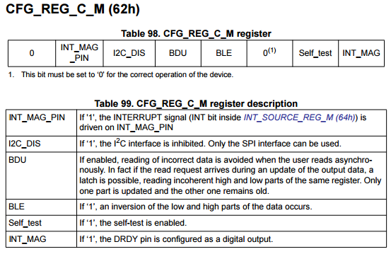

Hello Jason,
finally I was able to replicate your issue. Please try to connect INT3 pit on STEVAL-MKI172V1 to Vcc or GND through some resistor (i.e. 100kohms). It seems the pin 7 (INT_MAG/DRDY) of LSM303AGR cannot be left unconnected and must have pull-up or pull-down. If I did it the current consumption was as expected. I have contacted sensor specialist to investigate more this issue.
Posted on August 23, 2017 at 10:55
Hello Jason,
software solution is to set bit INT_MAG_PIN or INT_MAG in register CFG_REG_C_M (62h).
Basically the magnetometer interrupt pin cannot be left floating.
