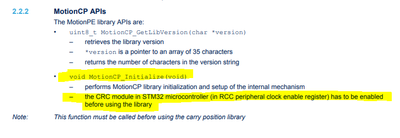

I have connected X-Nucleo-IKS02A1 to Nucleo H563Zi.When I am trying to initialize the MotionCP library using MotionCP_Initialize() function, it is not getting initialized and I couldn't step into it.But when I initialize IKS02A1_MOTION_SENSOR_Init(IKS02A1_IIS2DLPC_0,MOTION_ACCELERO), it is working.What may be the problem??

Hi @Priyaa ,
Please have a look at the user manual UM2224 where this is explained, you have to enable the CRC:
