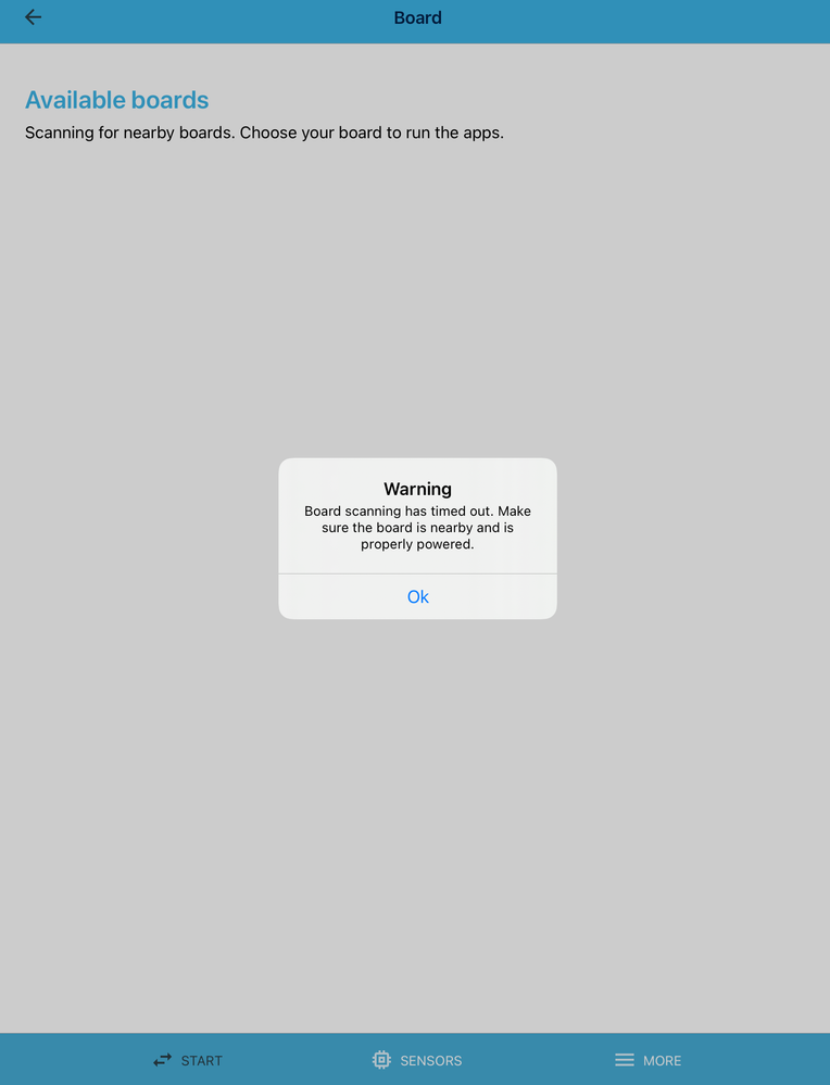

Hi, I have a problem about connecting STEVAL-STWINKT1B with ST BLE Sensor application. Bluetooth connection works. STEVAL-STWINKT1 appears in the list.
0693W00000Nqm3YQAR.pngIf I try to use the vibration monitor, WARNING pops up. I can't proceed with the next step .
I want to know why the sensor is connected to Bluetooth and it has timed out.

Hi @wkim.2​ ,
You probably tried to upload a predefined app from the "Create an app", but this button works only with the Sensortile.box tool.
You have to connect to the STWINKT not from the "Create an app" button, but directly selecting the STWINKT1 board you see (from "Connect to a device�?) on the list and connecting to it.
