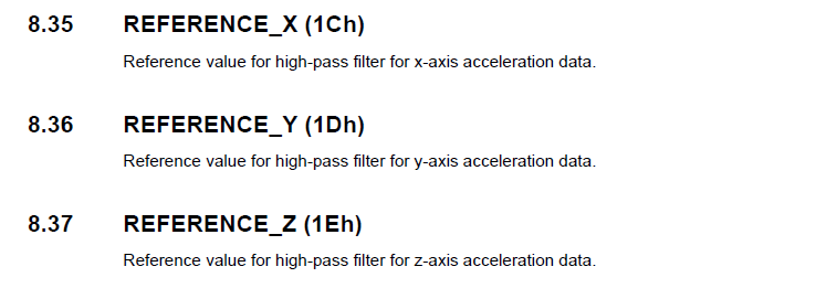

Secondly I would like to configure a High-Pass filter in order to reduce the noises on my click detection. It seems to be possible using the CTRL_REG0_XM, REFERENCE_X and REFERENCE_Y registers.
Could someone confirm me that the � Reference value � mentioned on those register�s description is the cut-off frequency of the filter.

The Reference registers do not define the cut-off frequency of the high-pass filter. The reference value is subtracted from the output value in case 'Reference signal for filtering' mode is used.

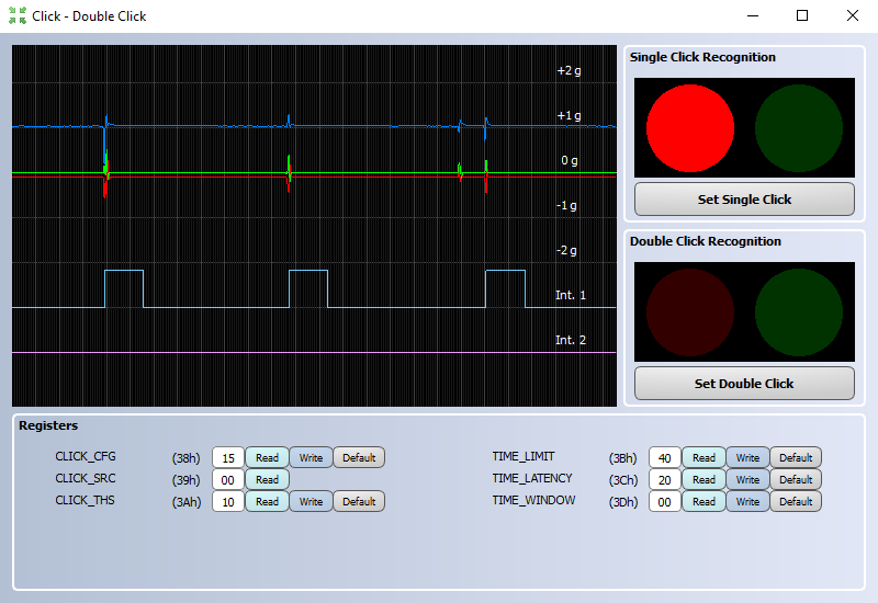

Hello again, finally I could make the click function work, but still there are a couple of open questions:
Could you please define a little better what is the meaning of TIME_LIMIT, TIME_LATENCY and TIME_WINDOW registers?
I've been playing with some values around, but still I couldn't figure out what's their exact behavior. In the datasheet the useage is quite vague...
Thanks!
Posted on November 17, 2017 at 15:02
If the device is configured for single-click event detection, an interrupt is generated when the input acceleration on the selected channel exceeds the programmed threshold, and returns below it within a time window defined by the TIME_LIMIT register.
If the device is configured for double-click event detection
, after the first click has been recognized, the second-click detection procedure is delayed for an interval defined by the TIME_LATENCY register. This means that after the first click has been recognized, the second click detection procedure starts only if the input acceleration exceeds the threshold after the latency window but before the window defined by TIME_WINDOW register has expired.
