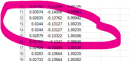

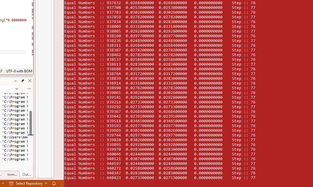

It is fully duplicate data, so now I need to check your log file for errors.  Thanks.
The duplicates are at 0.01 second intervals except when they are not.  When they are not they are at 149 and 2.
I like the two numbers 2 and 149 because they are both prime and 76 and 77 are not.

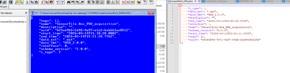

The acquisition files between the sd card and the USB cable are not in the same order for the same settings.
Thank   you to whoever made Sunday night after a day shopping with a daughter for a prom dress challenging.
It is just annoying.  They are not even reversed it is just random.

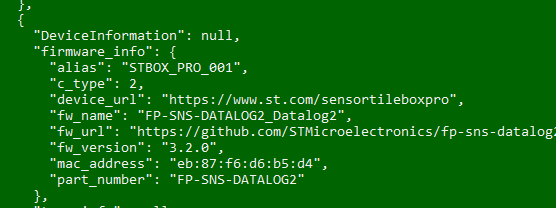

I am running the firmware that pops up after you install the 1.0.0., I think it is called 1.3.0 or some such.

The screenshot you shared shows fw_version 3.2.0. It is the latest, most updated one.

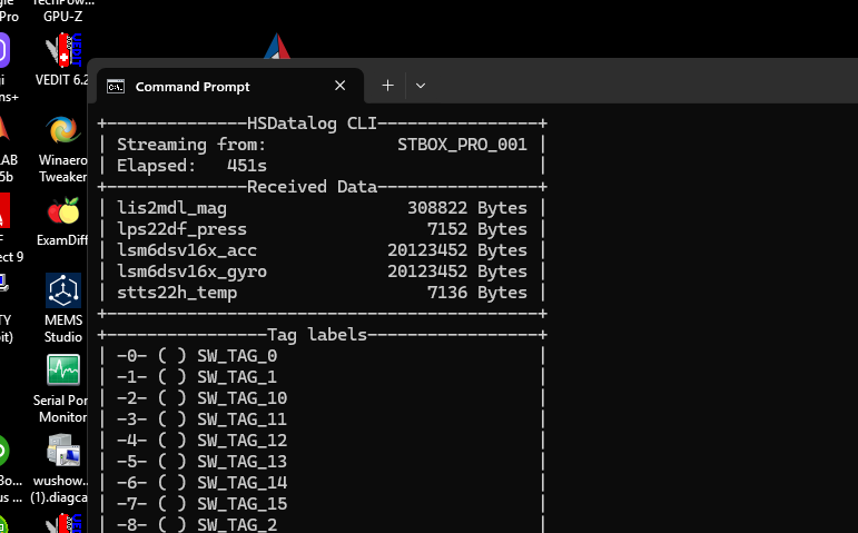

This is from the end of the day running your CLI Example that is compiled already. Note the bytes.

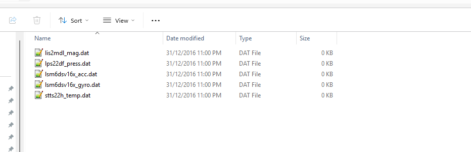

I pressed esc and got
Notice the zero file size, it is always recommended that you flush files as you write to the file.

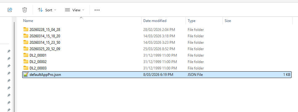

The DLetc files come with an interesting start date, The older files do not.

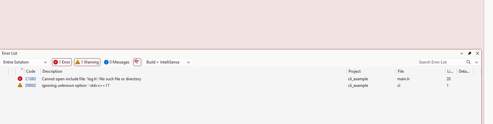

This is the SLNX file. The cmake does not create a solution that finds all of the log.h and 377 other errors once I fix that error.  I have traced all of your paths etc, but having an error that INT is undefined, is challenging.
I appreciate all of the work that has gone into this, but have you created a Windows 11 Visual Studio Solution, if so can I have it?
