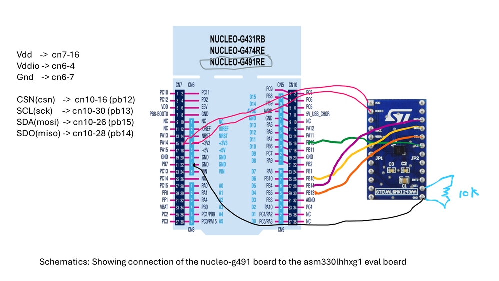

Connected STEVAL_$MKI243AA board to a nucleo-g491re board using 4 wire spi interface. The spi bus is setup to run @ 146 Kbits/sec. Reading back bad data.
WHO_AM_I is 0x48
PIN_CTRL is 0x3E
Not sure but seem like the device is power

Here is the sketch of my setup. The two evals boards are jumpered as shown with 8" jumper wires.
Project was created with STM32CubeMX and then debugged in STM32CubeIDE ver 2.1.1

A good, clear photo of your actual setup would help.
Check connections very carefully - particularly Vdd & GND.
These are quite prone to poor connections.
As noted above, your MISO behaviour very much suggests poor connections.

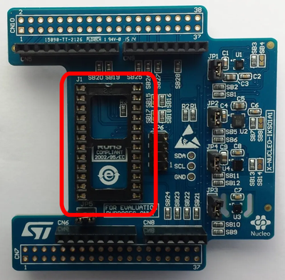

I would strongly recommend one of the X-Nucleo-IKS adaptor boards ("shields") - which accommodate the 24-pin DIL pinout; eg,
X-NUCLEO-IKS5A1 - X-NUCLEO-IKS02A1 - X-NUCLEO-IKS4A1
These models are Obsolete, but still usable if you happen to have one:
X-NUCLEO-IKS01A3 - X-NUCLEO-IKS01A1

Looks more like a hardware problem to me.
See my "delayed" post ...
