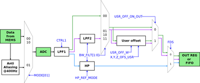

I am trying to configure the IIS2DLPC for anti-aliasing as indicated by figure 3 section 3.4 of an5201.
I am seeing frequency folding in the spectrum. I am playing a 300 and 500 Hz sine wave alternately on a sound table to vibrate the sensor. Each tone plays for 1.5s then switches frequency.
I had the IIS2DLPC configured for, High Performance, 1600Hz ODR, and Band Width ORD/4 or 400Hz. I was expecting the 500Hz to be strongly attenuated. Is my understanding of how the anti-aliasing filter works, or my setup incorrect?

what is the amplitude of the input signal? and what are the units of measurement of your plot?
