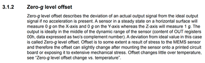

Can anyone tell me how to understand the following parameter out of the AIS2DW12 datasheet.
Zero-g level offset accuracy, long term: ± 700mg
When i use the sensor with a resolution of ± 2g, then I hope there ist not the possibility that the offset will drift this far.

If +/-700mg is too much for you, have a look at our AIS2IH which has zero-g level offset accuracy, long term of +/- 300mg, it is  designed to address non-safety automotive applications as AIS2DW12.

Yep, ±0.7g offset when the full scale is ±2g is a lot, but that's what it is.
