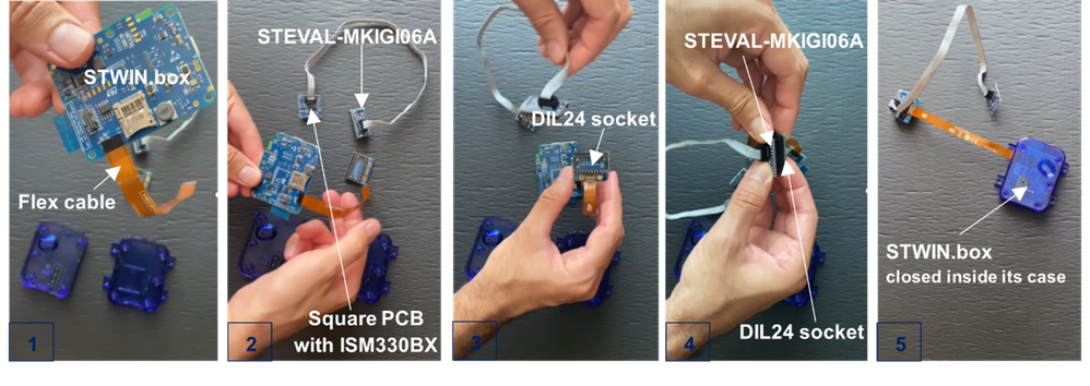

1. Hardware setup
The hardware we are going to use is the STWIN.box, an industrial board kit containing different sensors for developing industrial applications.
The STWIN.box can communicate with a mobile application running on the smartphone. Alternatively with a desktop application on your PC through Bluetooth® Low Energy or a USB Type-C® cable.
Moreover, there is the possibility to expand the board with external sensors.

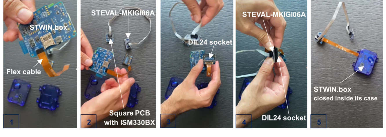

Since the ISM330BX sensor is not available on STWIN.box, we are going to mount it externally using the evaluation kit called STEVAL-MKI245KA.
This kit can be connected to the STWIN.box board through a flex cable and the DIL24 adapter board, as shown in Figure 2.
In particular, the STEVAL-MKI245KA kit is made up of a square PCB, which mounts the ISM330BX 6-axis IMU. It can be connected through flat cable to a generic adapter board (STEVAL-MKIGI06A). The presence of this square PCB ensures proper placement of the ISM330BX in the final application where we want to measure sensor data. The STEVAL-MKIGI06A can be plugged into a standard DIL 24 socket.
Figure 2: Hardware setup: STWIN.box and STEVAL-MKI245KAFigure 2: Hardware setup: STWIN.box and STEVAL-MKI245KA

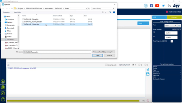

First, we need to program the board with the firmware called DATALOG2_Release.bin inside the package. To do that, we need to enable the DFU mode on the board for firmware upgrade. This can be enabled by keeping the button user pressed when connecting the USB Type-C® cable to the PC.
Figure 3: STWIN.box DFU mode is enabledFigure 3: STWIN.box DFU mode is enabled
Then we can use the tool STM32CubeProgrammer for loading the binary. In STM32CubeProgrammer, we can select the DATALOG2_Release.bin firmware in the binary folder and upload it to the device.
Figure 4: Loading of STWIN.box firmwareFigure 4: Loading of STWIN.box firmware
Now, the STWIN.box is programmed.

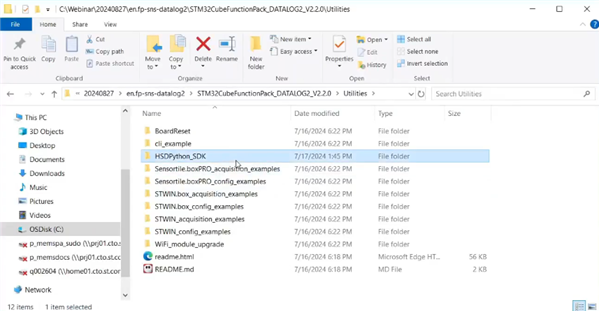

We are going to use the Python tools available in the function pack. Therefore, we are installing the high speed datalog Python SDK, in a virtual environment of Python version 3.10.
The user can find the details of the installation in the readme files available in the package.
Figure 5: HSDPython_SDK installationFigure 5: HSDPython_SDK installation

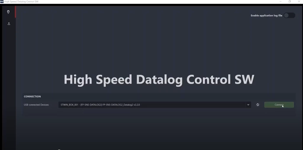

When the Python SDK has been installed, we can launch the high speed datalog graphical user interface.
In the GUI, the connect button allows the connection between the board and the PC.
Figure 6: High Speed Datalog GUI – Connect buttonFigure 6: High Speed Datalog GUI – Connect button

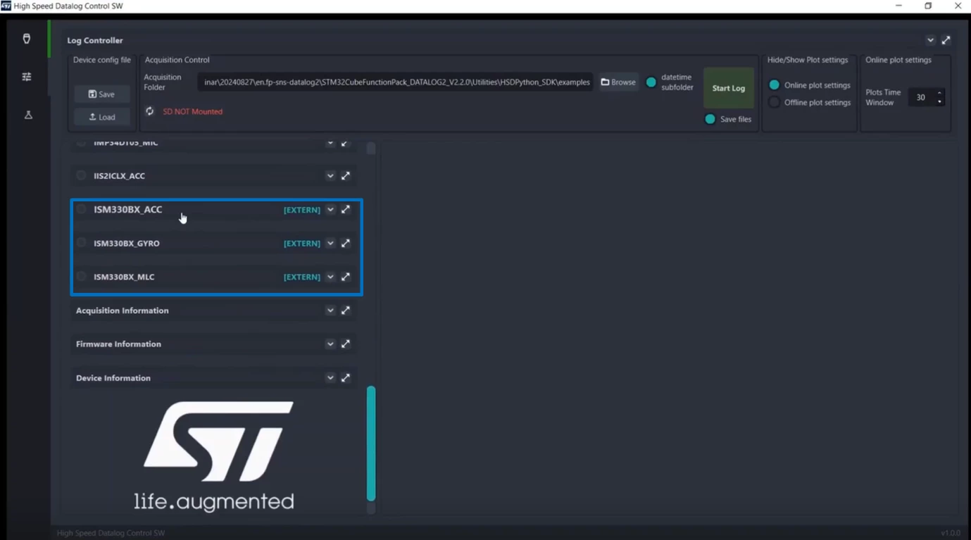

Once the connection is established, we can enable or disable the needed sensor.
In this case, we are enabling our ISM330BX.
Figure 7: High Speed Datalog GUI – Enabling ISM330BXFigure 7: High Speed Datalog GUI – Enabling ISM330BX

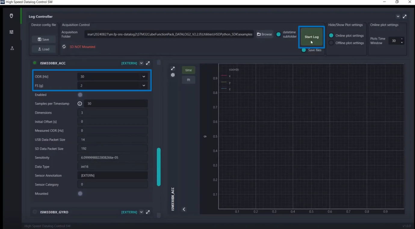

We can set up the data rate and full scale of the sensor. We can load the safe configuration and start and stop data logging on our PC.
Figure 8: High Speed Datalog GUI – Setting ODR and FS and Start/Stop loggingFigure 8: High Speed Datalog GUI – Setting ODR and FS and Start/Stop logging

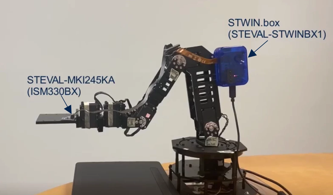

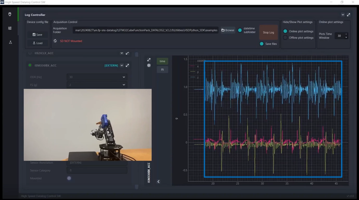

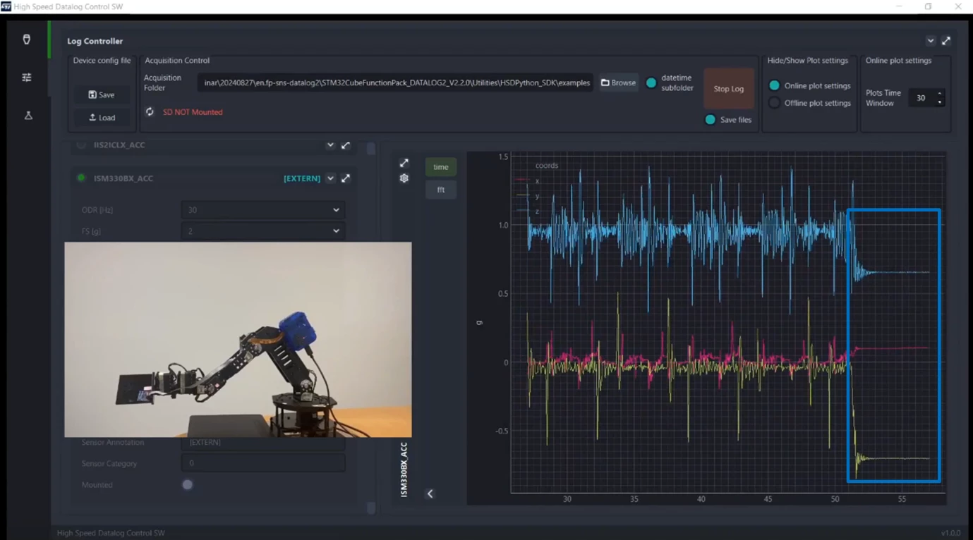

We have mounted the STWIN.box board and ISM330BX sensor on a robotic arm to show that it is possible to distinguish different conditions. Stationary, a pick and place movement, or any kind of anomaly that could happen when the cobot performs an unexpected movement. In this way, it can be automatically blocked.
Figure 9: STWIN.box and ISM330BX mounted on a robotic arm for anomaly detectionFigure 9: STWIN.box and ISM330BX mounted on a robotic arm for anomaly detection
We are going to program the machine learning core feature inside the ISM330BX to distinguish the different conditions.
So, we need to start collecting some datalogs on the classes we want to recognize.
We need to label data, choose some features, and build a classification model that in this case is based on a decision tree.
The decision tree is then embedded in the sensor configuration. We do this by using the hardware and software tools that we have seen so far plus MEMS-Studio for the machine learning core configuration.
Figure 10: MLC configuration in ISM330BX and STWIN.boxFigure 10: MLC configuration in ISM330BX and STWIN.box
First, we need to acquire datalogs with high speed datalog GUI.

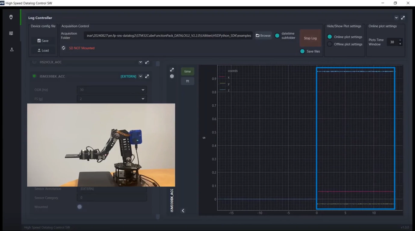

We are going to acquire limited data just for a quick demonstration. The first class is stationary (see figure 11), then the pick and place movement (see figure 12), which is repeated multiple times. This movement is performed by the robotic arm to pick some object from one location and place it to another location.
Finally, the anomaly (see Figure 13) which stops the cobot.
Figure 11: Robotic arm – Detection of stationary stateFigure 11: Robotic arm – Detection of stationary state
Figure 12: Robotic arm – Detection of pick and place movementFigure 12: Robotic arm – Detection of pick and place movement
Figure 13: Robotic arm – when the anomaly is detected, the robotic arm stops movingFigure 13: Robotic arm – when the anomaly is detected, the robotic arm stops moving
