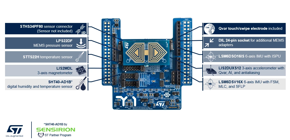

X-NUCLEO-IKS4A1: the new expansion board
X-CUBE-MEMS1 supports the new expansion board X-NUCLEO-IKS4A1, which offers the latest generation of ST MEMS sensors, which are open, accurate, and smart. This new expansion board has been developed relying on the STM32 open development environment (STM32 ODE). This open development environment is an open, flexible, easy, and affordable way to develop innovative devices and applications based on the STM32 microcontroller family.

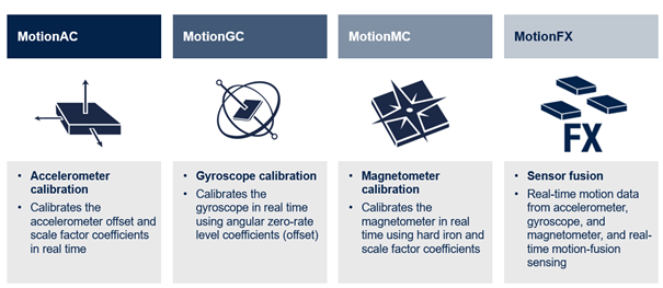

Inside the X-CUBE-MEMS1 package, there are several libraries:
- The MotionAC library, which allows to calibrate accelerometer offset and scale factor coefficients in real time.
- The MotionGC library for gyroscope calibration, which uses zero-rate level coefficients to calibrate gyroscope data.
- The MotionMC library, which allows to calibrate the magnetometer using hard iron and scale factor coefficients.
You can combine data coming from different sensors using the MotionFX library that provides real-time sensor fusion data for all the motion sensors.

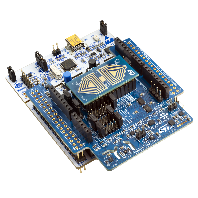

While downloading this package, you can start mounting the X-NUCLEO-IKS4A1 expansion board on top of the NUCLEO-F401RE board.
The new expansion board X-NUCLEO-IKS4A1
Then, you connect the Nucleo board to the PC through a USB cable.

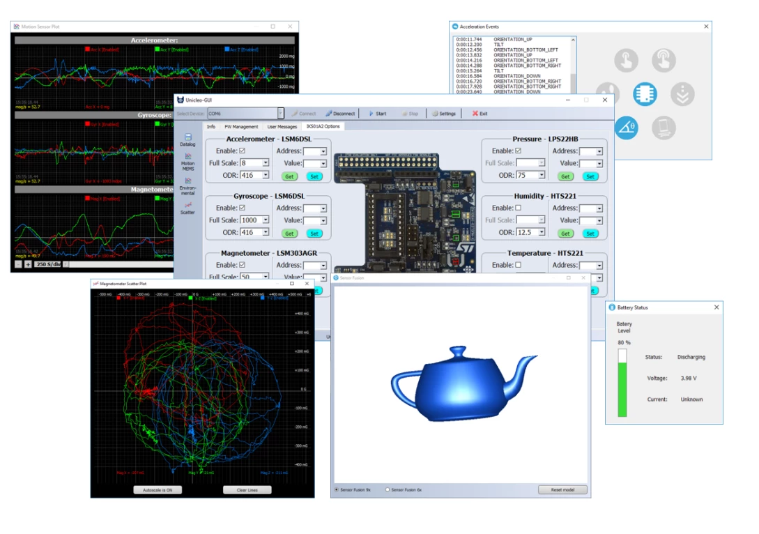

Once the board is flashed, you can use a software tool to evaluate the board, such as Unicleo-GUI.Unicleo-GUI communicates with the STM32 Nucleo board to get data from the sensors acquiring data logs. The software shows sensor outputs as numeric values and plots. With Unicleo-GUI installed, you can visualize data from all the sensors available in the X-NUCLEO-IKS4A1 board and you can perform data logging.

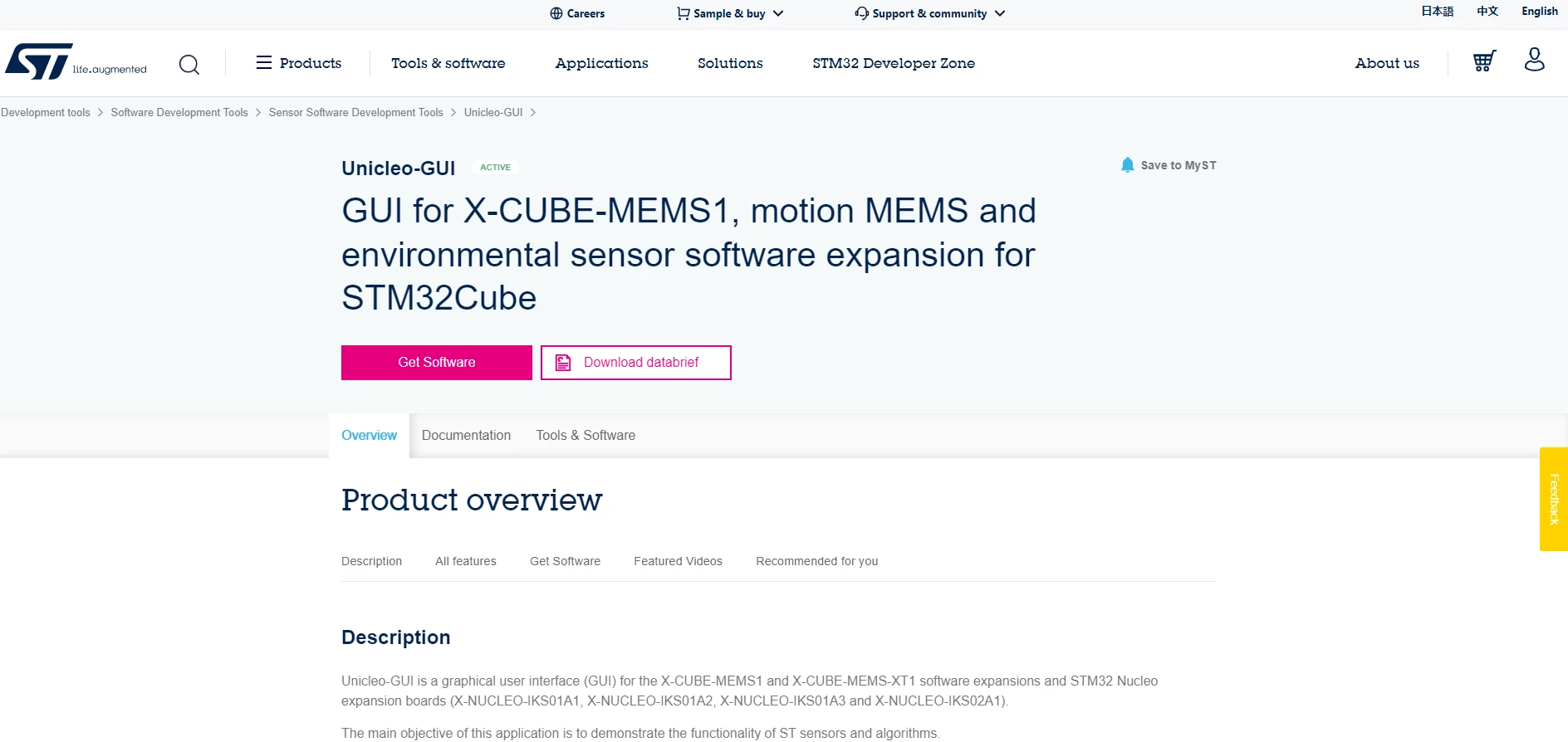

To run the application, it is needed to install and launch the Unicleo-GUI on a PC.
Unicleo-GUI software tool
After a connection has been established, the following is possible:
- View the data from various on-board environment sensors like temperature, humidity, and pressure
- View data from various on-board inertial sensors as well like accelerometer, gyroscope, and magnetometer
- Visualize the data as graphs
Unicleo-GUI graphical user interface
