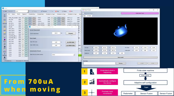

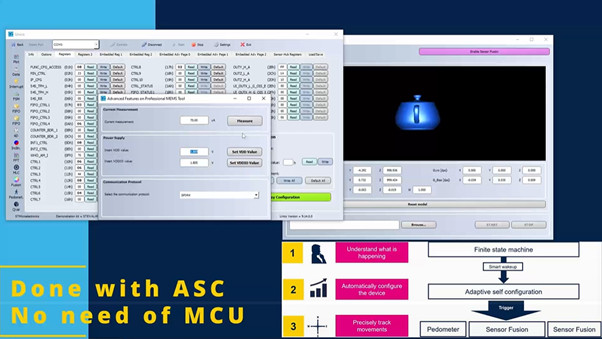

Unico-GUI: Enable the ASC feature
The current consumption drops significantly to almost 700 µA when moving
The current consumption drops significantly to 70 µA when stationary
