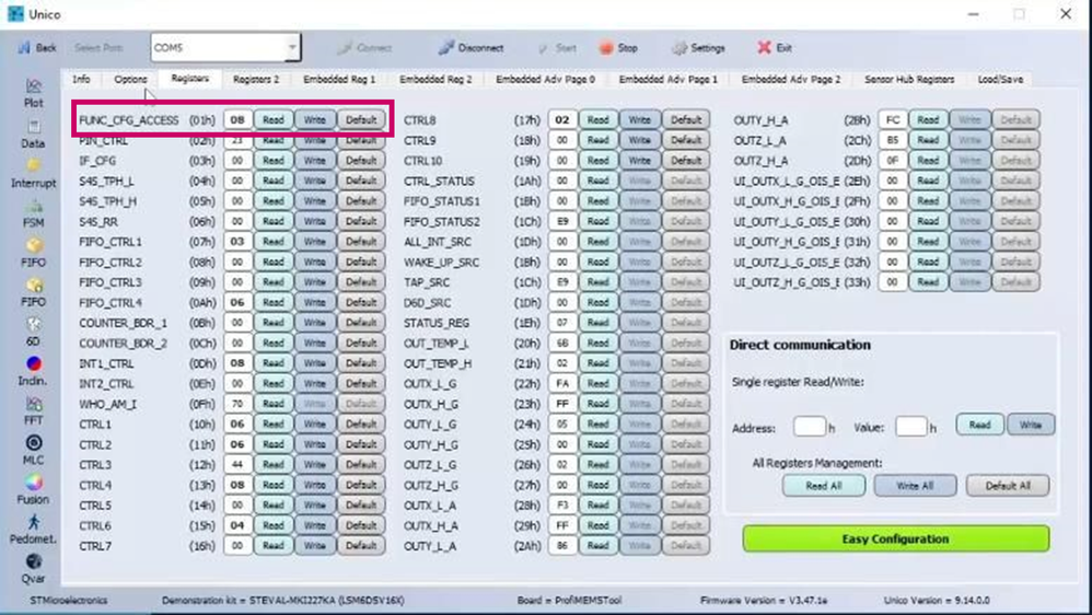

Unico-GUI: Click on the load button and select the downloaded .ucf file

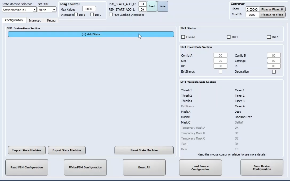

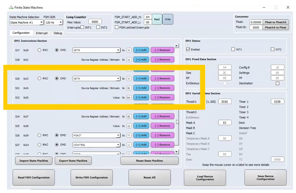

Unico-GUI: FSM window

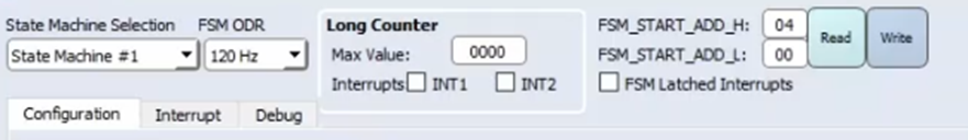

The FSM ODR is aligned to the sensors ODR (120 Hz)

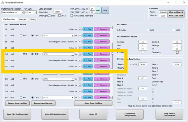

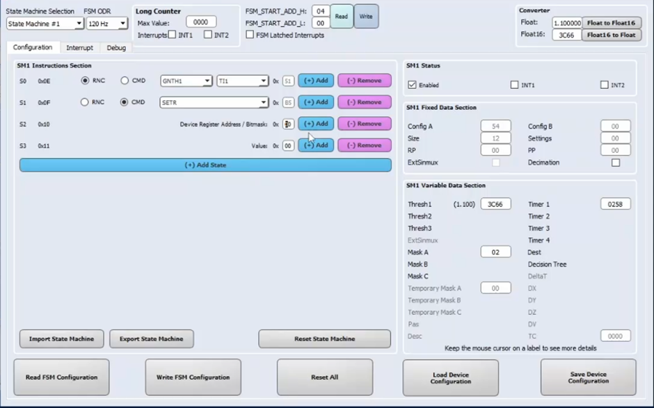

Unico-GUI: FSM - two SETR commands to change the accelerometer power mode and to turn off the gyroscope
Unico-GUI: FSM - SETR command to disable the pedometer 2.0 during the stationarity

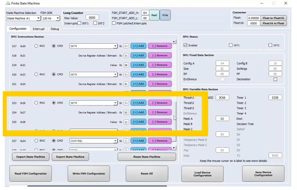

Unico-GUI: FSM - SETR command to disable the MLC during the stationarity.
Unico-GUI: FSM - a SETR command to enable the pedometer 2.0 after the smart wake up is detected
Unico-GUI: FSM - SETR command to enable the MLC after the smart wake up is detected
