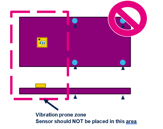

Figure 9. Placement of sensor in area without vibrations

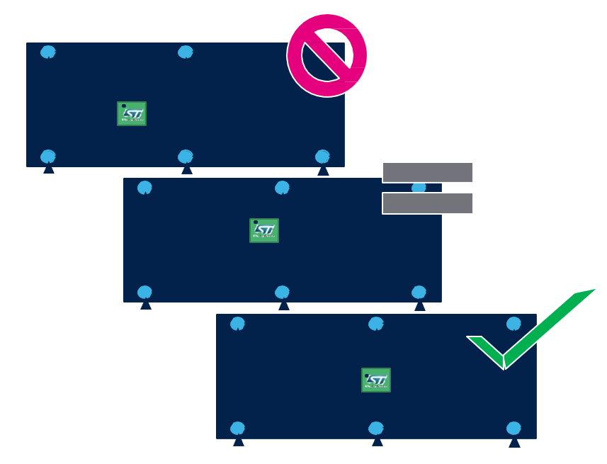

Figure 8. Placement of sensor between fasteners
