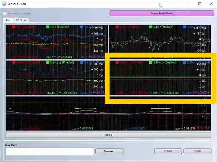

Figure 2. Offset drift resulting from thermomechanical stress

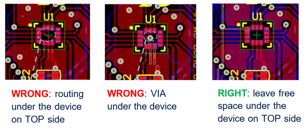

Figure 3. Footprint design rules
Figure 4. Correct traces
Figure 6. Examples of bottom side placement
Figure 7. Example of incorrect layout from real case
