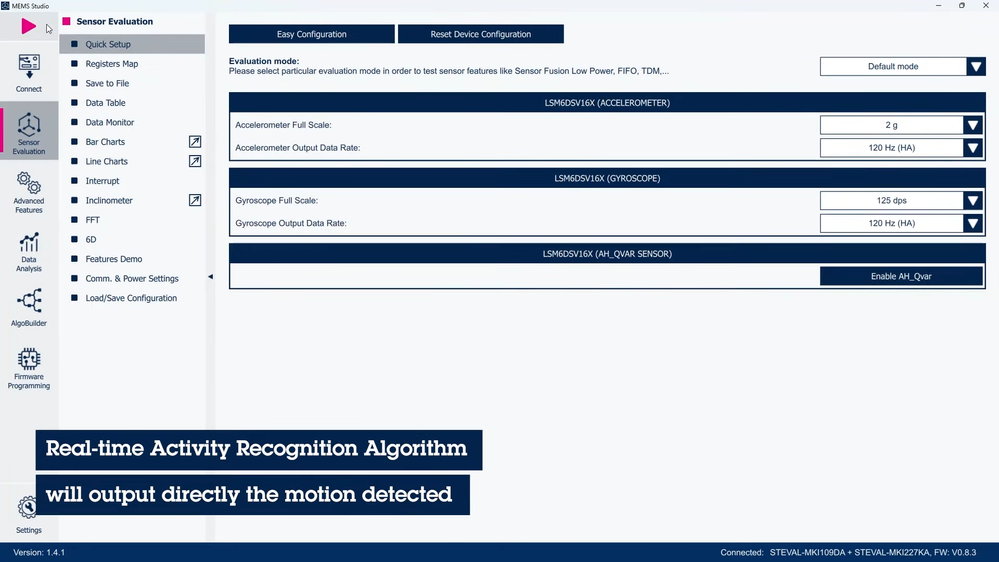

Figure 9: MEMS Studio - Sensor Evaluation, quick setup
