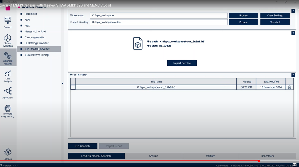

Figure 18: MEMS Studio - Advanced Features, ISPU Model Converter, NN model

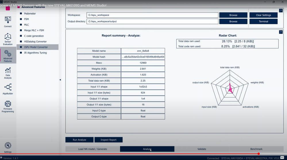

Figure 19: MEMS Studio - Advanced Features, ISPU Model Converter, Radar Chart
