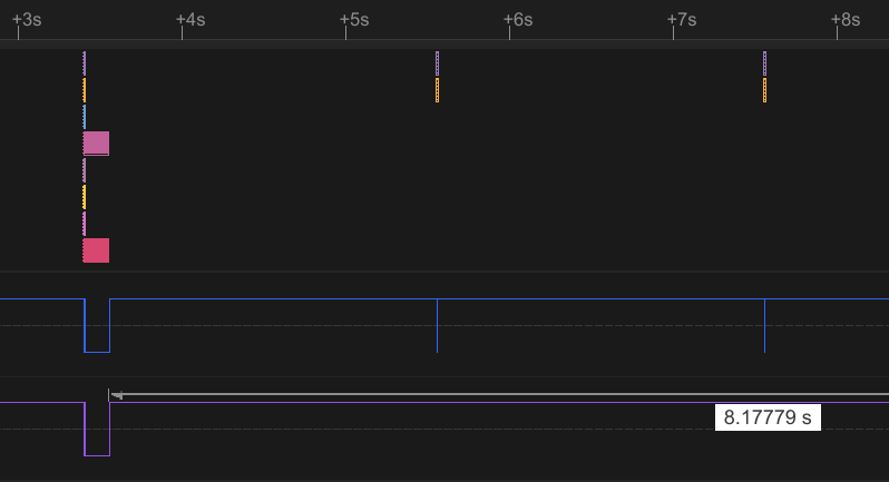

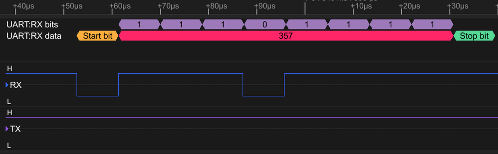

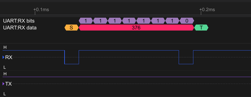

Observing the Signals on the UART-Pins (UART1_Tx and UART1_Rx) I get the following:
Big picture:
1st transmitted byte 0x7F
2nd Transmited byte(after 2 seconds)
In both cases, there is no response from the BLE Board.
