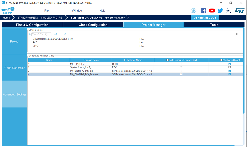

I've followed the step for SensorDemo application on Nucleo-F401RETx
6.2 Use of Expansion Software with sample applications
and all it's ok till the Advanced Settings tab config (fig 18) becouse in my CubeMX USART2 doesn't appear (see attached picture).
Do you have an idea why I don't see USART2 in my Advanced Setting tab?
Thank you very much.
I'using CubeMX 5.1.0 and X-CUBE-BLE1.4.4.0
