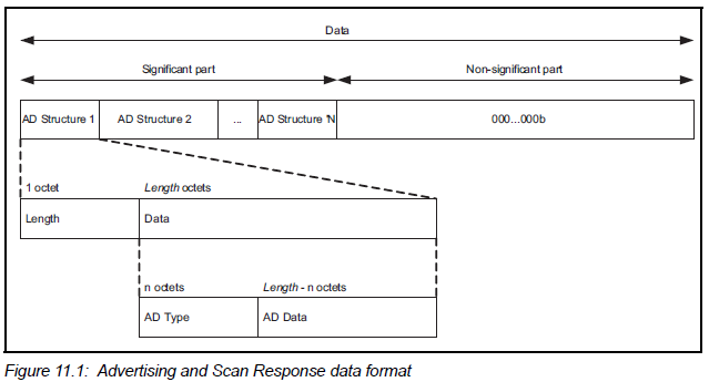

The complete advertising data (or scan response) is supposed to be in *Data, in the followed format:

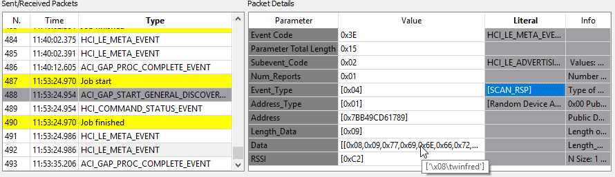

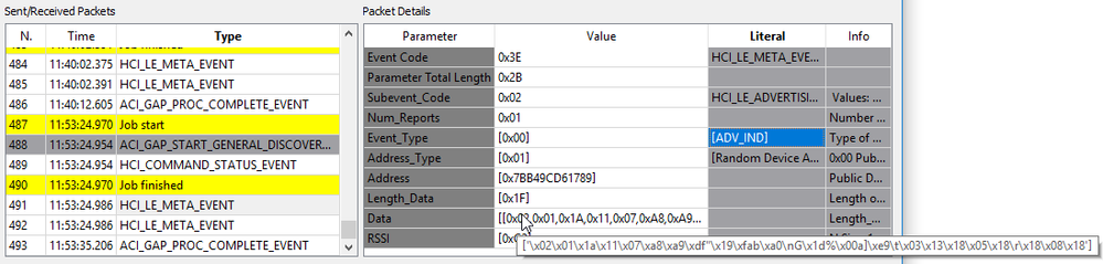

In your case, AD data type 0x01 and 0xff consist 31 bytes, and there shall be one more following report (event) containing the AD data type 0x08, 0x0a, and 0x03.
I replicated the advertising more than 31 bytes with "nRF Connect", the follow screenshots show data separately in two events:

Winfred LU
Hi Chong,
Yes. The second advertising report will have Event_Type equal to 4 (Scan Rsp), which is actually the response to the active scanning.
The primary advertising report may have Event_Type from 0 to 3 according to advertiser settings.
It is the beacon (advertising data) sent periodically every advertising interval.

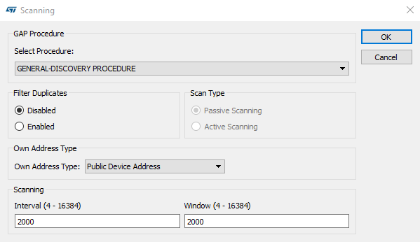

Hi Chong,
There is no such limit.
Possibly you configured the scanning window too short, so only 12 advertising packets can be scanned in that tiny period.
Please configure scanning interval and window properly.
It will be fine to set the scanning window the same as interval.
Best Regards,
Winfred
