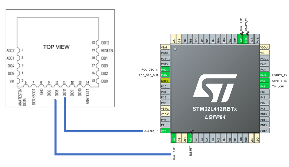

I designed a PCB with an STM32L412RBT6 and a BlueNRG-M2SP, and I checked the connection and I can't read data from the bluetooth module and I can't send data from the STM32.
I made the following code:

Here is a diagram of the connection between the component
0693W00000KcGmRQAV.pngI don't understand why it doesn't work

If you initially call HAL_UART_Receive_IT and have enabled the interrupt in the .ioc view (NVIC), the code looks reasonable. You may loose chars, because you read char by char. This is an often discussed topic here and you might eventually switch to DMA or such.
But, if it doesn't work at all, for hardware bring-up I would not use interrupt mode but polling. Probably at register level, to rule out any software issues. Like "connecting" USART1 and USART2 internaly by few lines of code.
hth
KnarfB
You have no calls to transmit or receive in the posted code. You sort of have calls to receive, but they're within an IRQ which is never called by the posted code.
Ensure BlueNRG-M2SP is set up in UART mode.
Thanks for the answer, I found out why I can't receive, I forgot to call the receive function in the callback and in main.
