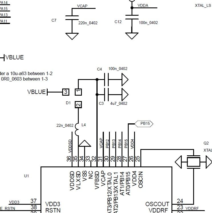

I'm confused in regars of BOM for SMPS for BlueNRG-LP. In the Reference Manual we can see the following recommandation:
0693W00000StxJnQAJ.jpgand in the document for the evaluation board there is another solution:
Would it be possible to get an answer if both are correct and which of them is better to use and why?

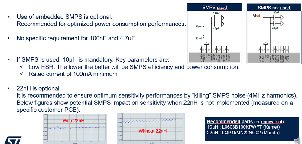

I hope attached picture will clarify your concern.
Figure 10 of RM0479 is showing both possibilities when using SMPS or not.
When SMPS is used, we must set a 10uH (preferred) between VLXSD and VFBSD.
A 1.5uH or 2.2uH can either be used but will give lower efficiency.
Then our reference schematics is adding a 22nH is series (see explanation in picture attached).
This 22nH is optional and can help in sensitivity performances.
The component D1 is used either with a 10uH in position 1-2 is SMPS is used or with a 0Ohm in 1-3 position is SMPS is not used.
Hope that clarifies.
In any case, please try to follow as much as possible the STEVAL-IDB011V2 reference design.

GBedn.1
Hello Laurent,
Thank you for the answer - very appreciate it. Now I see the cause which made me confused - there is a lack of "H" in the comment to D1 on schematic :) (it is "10u" instead "10uH") however I sould more carefully check the BOM document for IDB011V2 and then I would notice the "H" :)
I designed my board basing on IDB011V1 and works fine so far.
