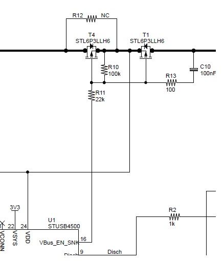

Two related questions for you, referring to the below paste from the STUSB4500 eval board schematics:
  1. You are saying that even when a non PD power supply is connected, the 4500 will assert the VBUS_EN_SNK pin low and by that enable power to travel from the VBUS to the VSNK output?
  2. Why are there two FETS (T1 + T4) here? Isn't one enough?

  1. Yes, with an exception that if POWER_ONLY_ABOVE_5V is set (to high), the VBUS_EN_SNK pin is only asserted when either PDO2 or PDO3 (both are PD only) contract is established.
  2. T1 acts as an on/off switch ; T4 is to ensure Type-C receptacle is a cold socket - not turned on until something is plugged in
If removing T1, it will not compliant with the standard. Therefore, it is not recommended to remove T1.
If removing T4, there will be no negative voltage protection and no reverse battery protection. Thus, you may trade off keeping it against removing it based on your application needs.
