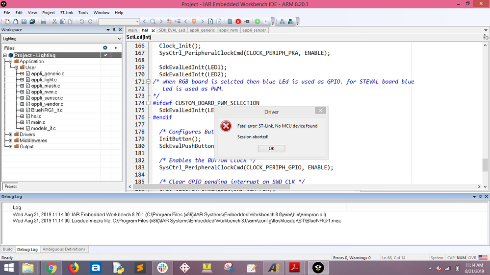

0690X00000AA05LQAT.pngHi Sir,
Greetings of the day,
Here, I am using the BlueNRG-1 development boards. I downloaded the SDK from the st.com. I am getting an error message as follows while flashing. I am using st-link /v2 to flash.
Please help me.

Kindly confirm if you are using STEVAL-IDB007V2 boards ?
Can you also try to do drag-drop of the .bin file to the driver created for this board ? Does it get programmed ?
