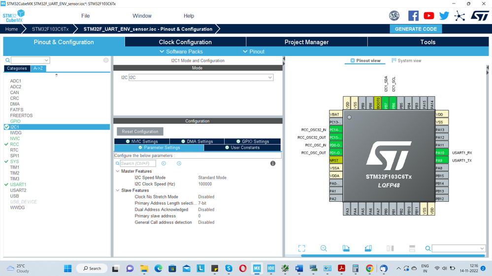

attached is the code ..I am using STMcubeID to run the I2C..I am trying to access sensor data using STM32 along with sensiron chip...but I I2C is not working...Let me know if you have any idea

ANy configuration needs to be done using STM cube Mx which is missing kinfly

before review of SW code, would you confirm that I2C bus is well pulled up by resistors? and more detail information may be helpful instead of "not working". for example NO ACK from sensor or something else.

I am seeing a timeout error inside HAL_I2C_Master_Transmit()...
I have pull up 4.7K resistor...where could be the issue...kindly let me know...any idea kinfly suggest

yes I2C is well pulled up using 4.7 K resistors and on probing also the line is showing 3.3v...when oscilloscope is connected no activity is seen on the bus...

we would like to confirm whether we have missed anything on the I2C configuration on STMcubeMx ..
Any IDE issue seen here...let us know...thanks
