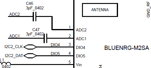

Hello, I've been using the STEVAL-IDB008V1M to help develop an BLUENRG-M2 product for an company. I've noticed in the schematic there are 3pF capacitors connected to the ADC Input 1 and Input 2
0693W00000BcjVdQAJ.pngDoes anyone know why this is done?
For the time being I have linked across this. I'm using the ADC polling example code and for some reason I always read 1239mV even with no power source connected.

Its odd because using "ADC_Input_BattSensor" instead of "ADC_Input_AdcPin1" in the ADC_Configuration function results in a accurate measurement.
I hope someone can help.
1 REPLY 1
JoBu
Old topic, but I've got the same issue. I was wondering why DC measurements don't work. Finally I found C46 and C47, bridged them and since then it's working fine. I'm really wondering what their purpose is. I find it really counterintuitive not to be able to measure DC.
