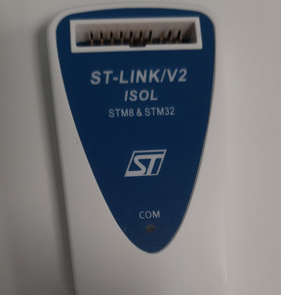

Dear community, I'm using steval idb008v2. I'm trying to debug it with stlinkv2. Is it possible to do it or not? Do I have to move some pins or something similar? The application replies me that so stm32 board is not connected. Any suggestions please?thank you,

Can you please show me a photo of the STLINK/V2 you are using first?

OK, what happens when you try to access this ST-LINK/V2 ISOL with the STM32CubeProg? Does it show a serial number and can you update the firmware to the latest version?
