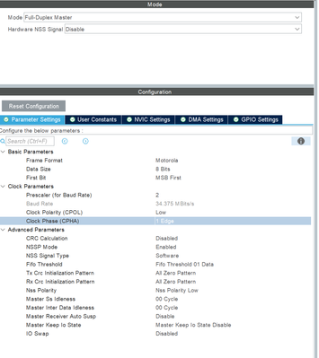

Hi!
I am trying a very simple test to receive the correct boot-up sequence which should be 0x55 0xAA and I am using this code:

I have tried three different boards with the NUCLEO-67W61M1 but with the same faulty result:
*** Bare-metal ST67W SPI Test ***
Waiting for SPI_RDY...
RDY boot detected.
RX: 01 55 00 00 00 00 01 00
Feels like some timing issue, but I am using the same SPI settings as in CubeMX examples:
Many thanks in advance for any hints

EPASZ.1
A reason for this is probably that the binary on the NCP is not updated to the same version as the host FW. The 0x5501 value was used in the initial SW in modules shipped after the release.
I'd suggest updating the binary, using to the attached scripts in \Projects\ST67W6X_Scripts\Binaries - described in https://wiki.st.com/stm32mcu/wiki/Connectivity:Wi-Fi_MCU_Hardware_Setup#Flashing_the_ST67W611M1_using_QConn_Flash_with_an_STM32_host
Thanks,
I have tried most of it without success and I suspect a faulty NUCLEO-67W61 board. To rule out I have now ordered a new one.
In the meanwhile, is there any source code available for Bootloader.bin, UART_bypass.bin that could be adopted for other than the listed boards?
Thanks in advance
