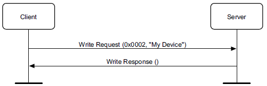

There is no state diagram for characteristics reading or writing. After connection is established, application may read and write whenever it is needed.
To read a characteristic value, it would be ok to use ACI_GATT_READ_CHAR_VALUE with corresponding attribute handle:
To write a characteristic value, it would be ok to use ACI_GATT_WRITE_CHAR_VALUE with corresponding attribute handle:
