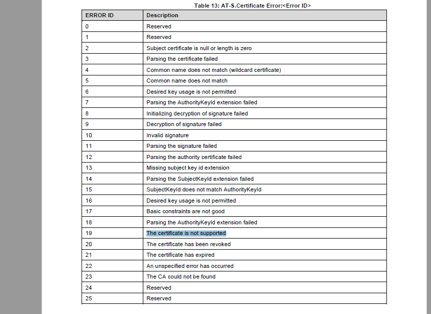

Mario Ghecea
Posted on October 31, 2017 at 01:32
According to the Certificate Error : 19, returned by firmware socket, that message means that the certificate is not supported!

Posted on October 31, 2017 at 01:30
Now I'm having a different issue with FRED and websockets...I'm getting certificate issues...
I post to my node-red installation on FRED via websocket (tests ok from my javascript and posts fine to FRED) but has issues from hardware on SPWF04SA...
My websocket connects internally to an MQTT broker, which I could not get going directly, no matter what I do...But it seems I'm also having issues connection to the websocket as well...Seems no matter what I post to FRED, I have created all sorts of endpoints, these secure connectivity issues persist!
AT+S.WSOCKON=dreamsmatrix.fred.sensetecnic.com,443,/api/public/mqtt,2,,,,,
AT-S.Certificate Error:19
AT-S.WebSocket Client Error:1
AT-S.ERROR:74:Failed to open socket

Posted on October 31, 2017 at 03:05
Same thing happens when I send any TLS requests...Any way to setup the certificate option for SSL ? I don't have much documentation on that...I believe its an
https://community.st.com/external-link.jspa?url=https%3A%2F%2F
request according to CURL, which works by the way and so do websockets sends from java scripts. I just need to enable certificates on the firmware ?
AT+S.HTTPPOST=dreamsmatrix.fred.sensetecnic.com,/api/public/magnum/wifi/{'Data':'12345'},443,2,,,,
AT-S.Http Client Error:2
AT-S.ERROR:111:Request failed
Posted on November 04, 2017 at 11:28
FW1.0.0 only supports RSA-based certificates. No ECC-based certificates. What kind on certificates are you using? Please refer to AN4963
Posted on November 08, 2017 at 04:41
Yup I'm missing the server side certificates...Seems anonymous mode does not get supported in TLS2.0.
