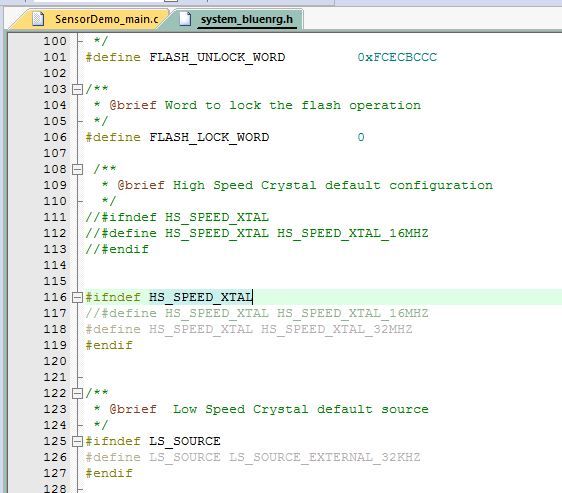

2019-01-03 11:39 PM
Hi Aontonio,
i am using the EVAL-IDB007V1M board and Keil V5.
as per your previous discussion ,i change 32 Mhz and it works for "hello World" example.
here, i modify "system_bluenrg.h" file.
But BLE programs are loaded to EVAL-IDB007V1M board but the BLE Android applications not detect.
kindly give the solution...
