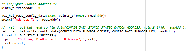

I am trying to read the MAC address from a BlueNRG device (345) after setting it via the RF Flasher Tool. However, the corresponding changes are not visible in the advertising parameters. I have used aci_hal_read_config_data() but still no output.
The code is  ret = aci_hal_read_config_data(CONFIG_DATA_STORED_STATIC_RANDOM_ADDRESS, (uint8_t*)6, readAddr);
I have set the mac address 0x000000000 currently using the tool at a flash address: Base address + flash image + a little offset.
Any help would be appreciated!
Thanks!

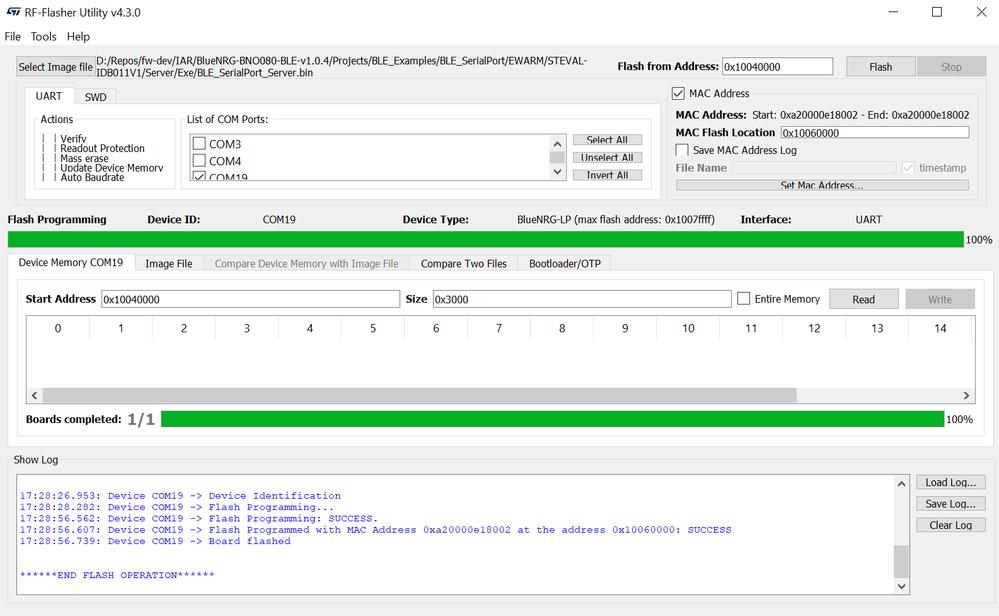

Please find the below images for setup. I am setting the public address.
The below is how I am setting it using RF Flasher Utility.
So I first read the address stored in the NVM, and then I write it using the aci_hal_write_config API call.
Thanks!

Ok : Let me also point this document : UM2406 : UserManual of the RF_Flasher section 6.
This tool is used to flash MAC address at a specific flash address as you did.
Anyway, in your application code, you must program it:
1- Read MAC adress at the flash address you flashed it.
2- Set this MAC adress using aci_hal_write_config_data(...)
Then a third step, of course you can perform a aci_hal_read_config_data() to confirm is has been well programmed.

Hi @Sebastien DENOUAL​ ,
Thanks for your help! I am able to set the MAC ID and read it too correctly. However, is there a fixed format or a predefined standard to set the MAC ID? I am trying to set it to something random, but the change is not reflecting in the flash memory contents. Only setting it to the MAC ID provided in the example codes in the Bluenrg LP DK is working, others are not.
Any reason why this might be happening?
Thanks again!
