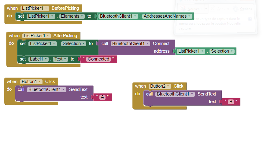

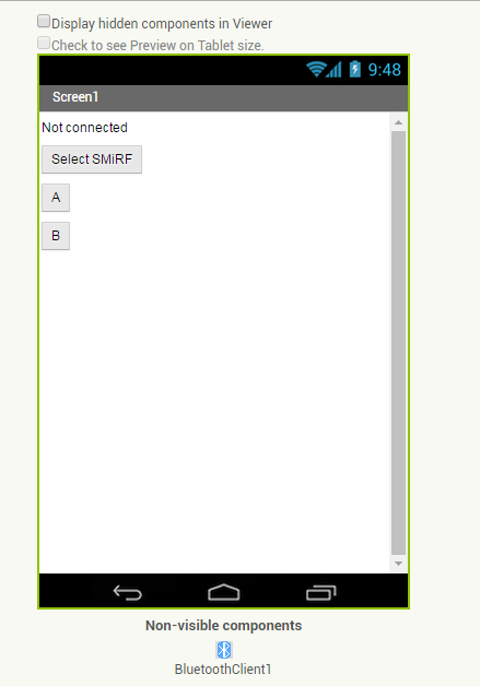

I've got a problem with this program I can't send a character with an application btle 'Error 507' Displayed on the app.What's the problem?

Dear Alexandre,
the error code that you get is related to your smartphone app, which is not developed by ST, so I don't know what that error code means.
Anyway, your STM32 code implements the Heart Rate Monitor (HRM) profile, i.e. it simulates sending heart rate information from your device to your phone.
In your app, you're trying to send some arbitrary text to the BLE device (which is not expecting it) and this is probably why you're getting an error.
