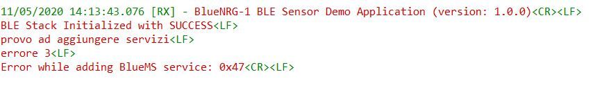

problem add service on gatt error 0x47, BlueNRG-2
Acane.11
hi, i'm using steval-idb00bv2 board ans i want to add my custom service to the other present on the example that already read the sensor present on the board.
this is the code that i have added and give me the problem

here the log from the uart

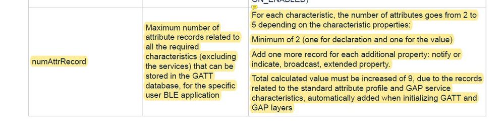

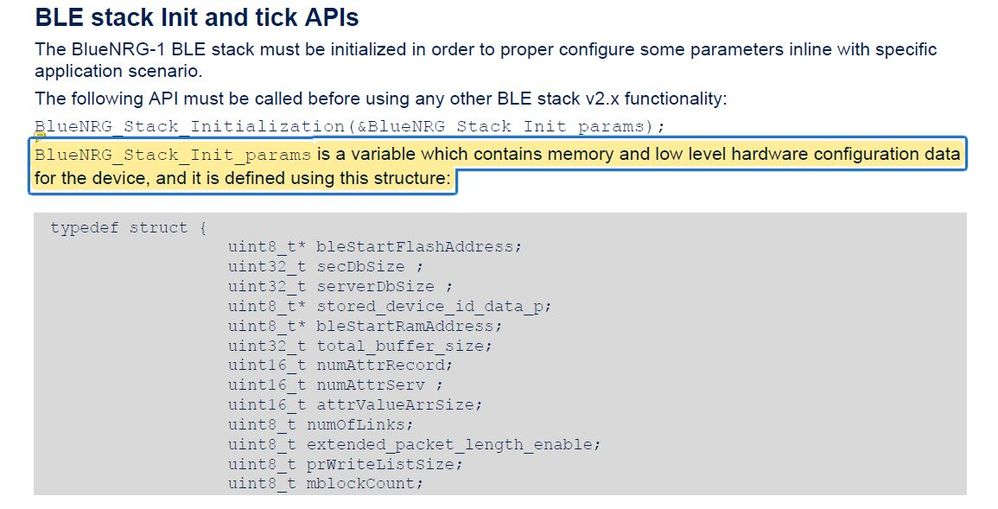

Hi, at the end i found the solution myself by reading the document PM0257, here i report the extract. before use a service or attribute it is necessary to allocate the relative memory space as describe on the table with the function BlueNRG_Stack_Initialization(&BlueNRG_Stack_Init_params);.
