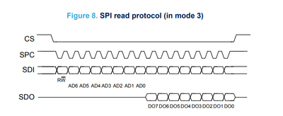

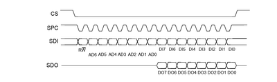

I ordered this IC for one of my products and am confused about the SPI modes. In the datasheet, it is mentioned that it will support SPI mode 0 and mode 3, but I have not found any timing diagram of SPI mode 0 in the datasheet. Can you provide me more details about this IC How can I change the SPI modes and on which mode this IC works fine, and the timing diagram of SPI mode 0?

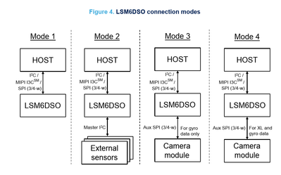

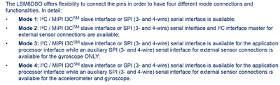

"mode" is also used for the operating mode , so this is confusing somewhat, see:
Also the interface can be in different "mode" : SPI , I2C , I3C -> depends on pin settings

Thanks for your reply. I think these are not SPI modes. These are connection modes.  I am asking about the SPI modes. In the datasheet, it is mentioned that it supports both SPI modes. Mode 0 and mode 3 as you can see in the attached screenshot.
But there is no timing diagram available for SPI Mode 0.

I know it will work fine on CPOL 1 and CPHA 1. but my concern is whether it will work on CPOL 0 and CPHA 0 or not.
