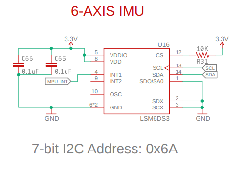

LSM6DS3 respond with address 0x7E
  • January 24, 2022
  • 2437 views
Hello Everyone,
I am working on a product and recently due to chip shortage I have to change the IMU. I have selected LSM6DS. My MCU is Esp32. now when I send a query of I2C address it responds with 0x7E address while it should be 0x6A. I was using Adafruit library and that is not working with the chip.
Can anybody help why this 0x7E or any workaround this? I have attached the schematics. the I2C pullups are 4.7K.0693W00000JN1spQAD.png

    Same Issue Here
    IRogo.1
    June 17, 2024
    0x7E is I3C command address. Disabling i3C feature will resolve this.
