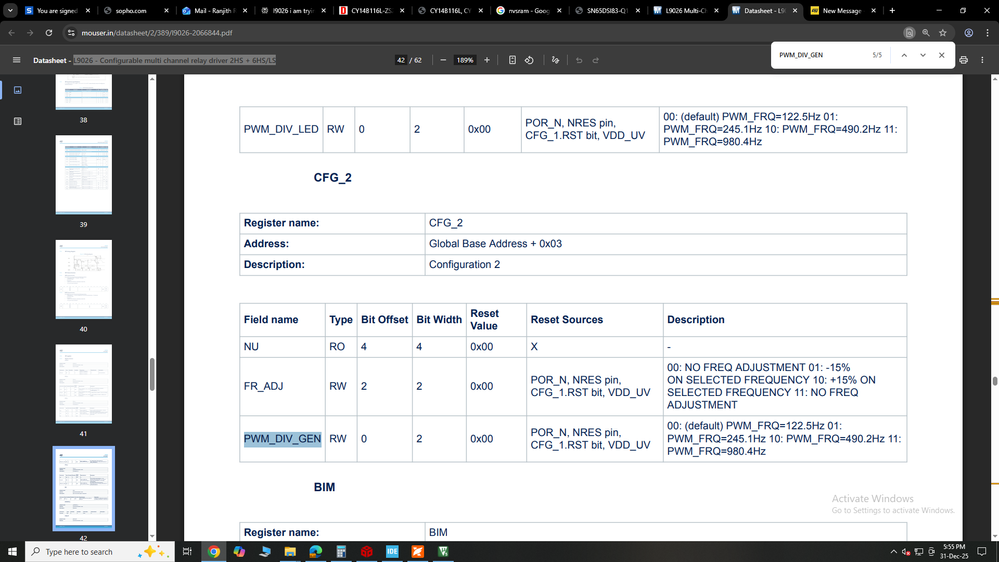

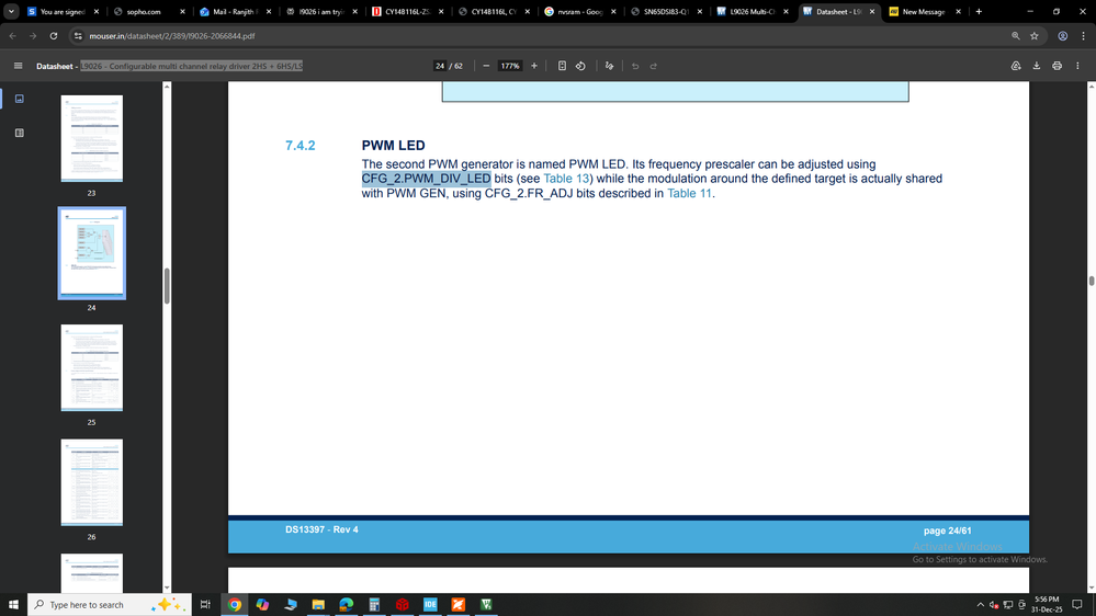

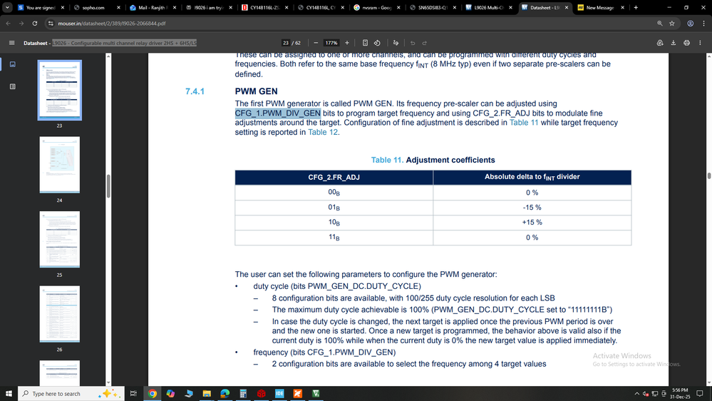

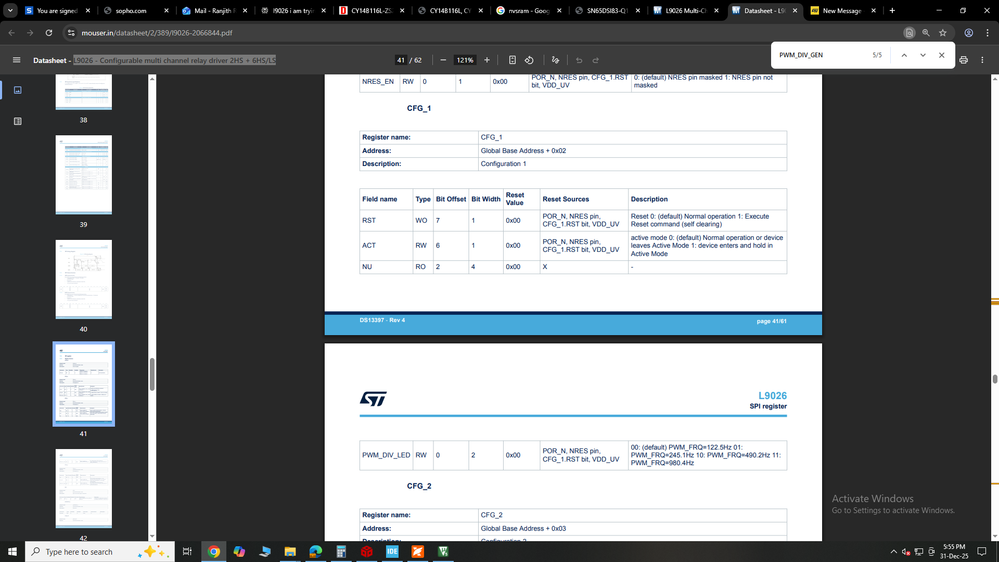

I am trying to configure the L9026 through SPI communication, but I am confused about configuring the CFG_1 and CFG_2 registers.
In section 7.4.1 (PWM Generator), it is mentioned as CFG_1.PWM_DIV_GEN, but in the CFG_1 register there is no field named PWM_DIV_GEN. Instead, PWM_DIV_GEN is present in CFG_2.
A similar issue exists with PWM_DIV_LED.
Please find the attached screenshots from the datasheet.
Please provide clarification on this.
