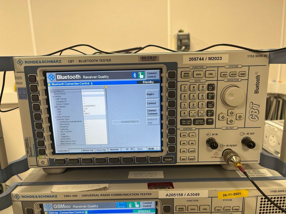

Is there any DTM (Direct Test Mode) firmware for BueNRG2 which could be used wireless (Not with serial UART or SPI) with the Bluetooth tester in the image?
RAlma.1
0693W00000aINpbQAG.jpgI need a DTM firmware for BlueNRG2 which works wirelessly with the equipment shown in the image. I wonder if ST provides their customers with such a firmware?

I do confirm DTM image provided in BlueNRG-2 SDK can be used for such purpose.
Please note:
  • You still need a UART interface between CBT tester and BlueNRG-2 (tester will send standardized command such as HCI_LE_TRANSMITTER_TEST etc. Not sure CBT has a USB interface (if it a
  • You may have to rebuilt DTM image in order to built it with LL_ONLY pre processing option so that vendor commands will be removed
I will share with you a doc that might be useful.
