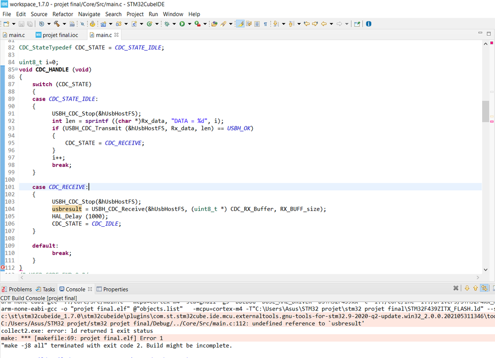

i've got this problem on cubemxIDE

Yeah, I'm not sure how the title, and the screen shot relate.
The screen shot shows the compile complaining you don't define the variable you're attempting to set the value into.
Where is usbresult defined? Is it in scope?
