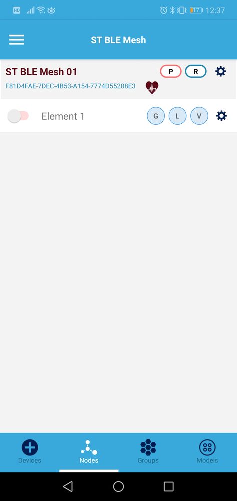

We are currently using BlueNRG-2 and STSW-BNRG-Mesh v1.10 embedded SDK. The Light LC Server Model is included and we would like to use it.
Does the current library capacity only support up to 1 element? Does it mean that Light LC Server Model is not available yet?
We have tried the following steps:
a. Enable Light LC Server Model
#define ENABLE_LIGHT_MODEL_SERVER_LC (2)
b. Atleast 2 elements are required for LC Server
#define APPLICATION_NUMBER_OF_ELEMENTS (2)
c. Other elements are:
#define ENABLE_GENERIC_MODEL_SERVER_ONOFF (3)
#define ENABLE_GENERIC_MODEL_SERVER_LEVEL (3)
#define ENABLE_GENERIC_MODEL_SERVER_POWER_ONOFF (3)
#define ENABLE_GENERIC_MODEL_SERVER_POWER_ONOFF_SETUP (3)
#define ENABLE_LIGHT_MODEL_SERVER_LIGHTNESS (1)
#define ENABLE_LIGHT_MODEL_SERVER_LIGHTNESS_SETUP (1)
I got the following warning message.
BlueNRG-Mesh Library Version = 01.13.000
[Library Capabilities]
Net Keys = 1
App Keys = 1
Elements per Node = 1
Models per Element = 12
Subscription per Model = 6
96260 Appli_BleSetNumberOfElementsCb --Number of Elements enabled in application exceeding from Library Capability!

Thank you for your reply. I got the following message too.

​Then, when I provisioned the device using ST BLE MESH app, I got the following message. Only Element1 is displayed in app as attached.
​Does it mean that the element 2 is not available in ST BLE MESH app? How can I use element 2 and Light LC Server Model?
13873 Appli_BleSetNumberOfElementsCb - Number of Elements enabled in application exceeding from Library Capability!
16497 Appli_BleUnprovisionedIdentifyCb - Unprovisioned Node Identifier received: 0a
17499 Appli_BleAttentionTimerCb -
18499 Appli_BleAttentionTimerCb -
19499 Appli_BleAttentionTimerCb -
20499 Appli_BleAttentionTimerCb -
21499 Appli_BleAttentionTimerCb -
22499 Appli_BleAttentionTimerCb -
23499 Appli_BleAttentionTimerCb -
24499 Appli_BleAttentionTimerCb -
25499 Appli_BleAttentionTimerCb -
26499 Appli_BleAttentionTimerCb -
31357 Appli_BleSetNumberOfElementsCb - Number of Elements enabled in application exceeding from Library Capability!
Device is provisioned by provisioner
AppKey Add received for netKeyIndex 00, appKeyIndex 00
Status is : 00
In BLE Mesh SDK, multiple mesh libraries exist with different configurations. The default mesh library supports one element only.
A library supporting at least two elements shall be used. Please link the appropriate library available at path Embedded\Middlewares\ST\ST_BLE_Mesh\Library\libBlueNRG_Mesh_CM0_2E_1N_1A_12M.a
