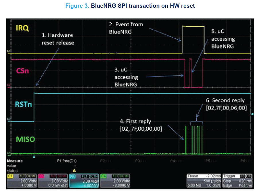

However, the initial response is not correct after reset - compare with chapter 3.5 Test procedure in the AN4494.

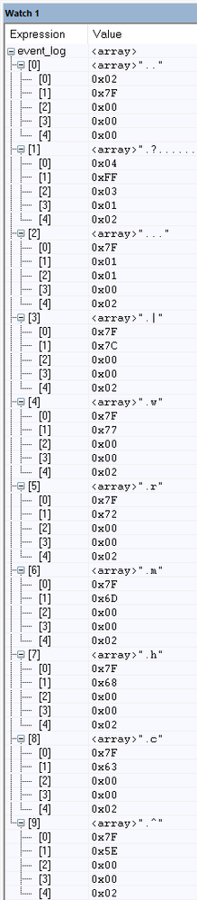

The first message after reset is correct, but the response is invalid from the 2nd reply.
04, FF, 03, 01, 00, 02 (<- should be 01)

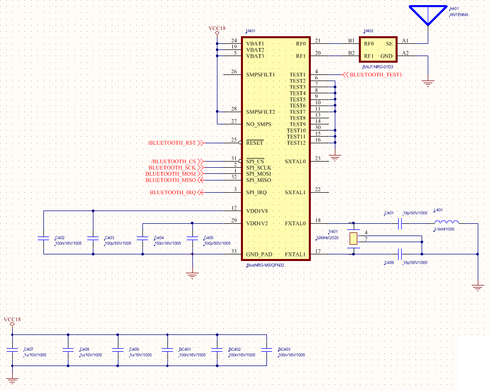

  1. I made a custom board with STM32L476RE (LQFP-64) + BlueNRG-MSTQR (VQFN-32) - it's not module, just IC and balun.
  2. I don't know, util I can't access the information of BlueNRG-MS IC.
  3. no resistor. However, I use the pulldown function of bluenrg_reset GPIO pin.
  4. timeout for any commands.

This is my captured messages after reset.
I referred the sensortile schematic, at first. so I attach the 32MHz crystal to the bluenrg.
It does not work correctly, so I change the clock source same as development kit's - steval-idb005v1d.
But the message does not change.

  • This is my design with bluenrg-ms
  • Change clock source as steval-idb005v1d. (16MHz + 32.768KHz)
           => initial message is same (finished with 0x02) and timeout for any command.
  • Change the NO_SMPS signal level as steval-idb005v1d (Pull-down)
What is the problem for me?
